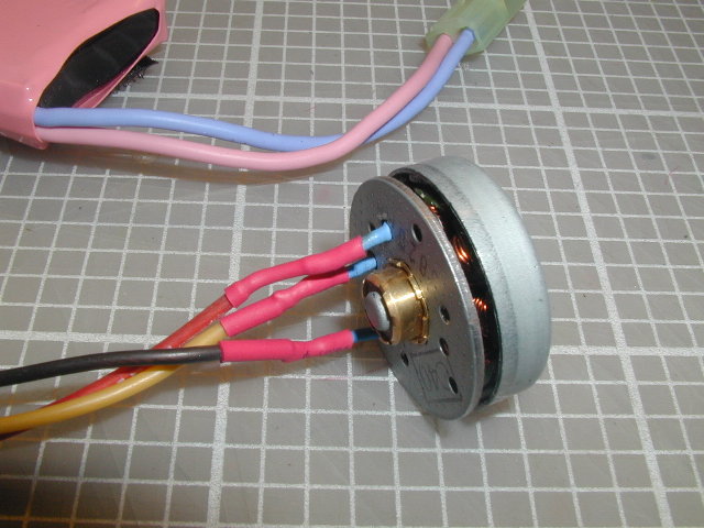

亞邦,我隻無碳刷搞掂啦。嘩勁度十足!似乎好夠力。未度加槳後電流有多大,相信都有5至8A。等亞子明賣隻電Bee比我,就可以把它裝上去試吓。
PostPosted: Tue Jun 01, 2004 9:35 am
Great to hear your good work done. However, it looks something wrong on the shaft. Coz the shaft shall be fixed to the bell (the outrunner), I worry that the bell might wear in high speed. In addition, I see plenty of space between each teeth, you might consider using thicker wire or increase number of winding. Regards,
pong. :P

The diameter of my CD-ROM motor is larger than others, that's why the gaps between the magnets are large. Yes, the shaft is not fixed to the outrunner bell, however, I found out that the shaft is tightly coupled to the bell when the bell turns in high speed and all the torque are coupled to the shaft that is turning the pop - at least I can not hold the shaft by my fingers when it turns, it's ok for now. I will fit a pop to check the speed it has tonight. The wire I used is not as thick as yours, this is the thickiest wire I can get hold of and is left-over stuff from my electronic hobby project twenty years ago!

I tested my homemade brushless motor again last night with load. When a 13" pop was installed, I found that the motor will start to shake a lot and will automatically cut off up to half throttle. However, with a smaller pop of 6" it can go to full throttle with speed and the trust it's generated is promising.
The shaking started with some kinds of small vibration first and then developed into full interruption of spin. It seems to me that the speed control (Jeti) does not handle the motor properly in high loading. Perhaps this is due to the spacing of the magnets which is not uniform or the gaps are too large. Any suggestion of the cause?
PostPosted: Wed Jun 02, 2004 12:57 pm
:D Hey Stanley,
13" prop is seems too big for this small BL. The interrupption of spin might be "misfire". Your red colour JETI cannot set the timing, I can borrow my blue one to you for test COZ it can set to hard timing. BTY, does your BL hot when using a 6" prop? :?:

Hi Ah Pong,
The motor was a bit hot when it was driving a 6" prop with full throttle but it is not as hot as such that you can't touch it with your finger. I think it's ok. I will check the Jeti speed control tonight to see whether I can program it with hard timing. I do have another Jeti SC (blue one), so I will try this if the red one cannot be programmed.

My red Jeti controller can not be programmed to hard timing mode, so I changed a speed controller (blue one, Advance 18P), but still the motor would stop at half throttle even it was drived in hard timming mode. I guess probably the loading of 13" prop is too high.

I've removed the bell from the motor, but have I got to remove the stator from the printed circuit board for rewinding of the wire ?
How can it be done! Should I force it out ?
PostPosted: Tue Jun 08, 2004 7:15 pm
:D from my very limited experience, I opine that the stator is better removed from the PCB. Otherwise, it would be so difficult for the winding. Each motor has their unique design. Therefore, no hard and fast rule to remove it. Just try. By the way, the best method to remove the old magnet from the bell is burning. call me direct if you encounter problem. Regards. :P

整好左個 CD-ROM BL 摩打啦。
我用左0.5mm既線打左 20圈
嘩!圈完之後,成隻手唔郁得。好辛苦 :cry:

Good work done. Coz it is quite difficult to wind 20 turns with .5 wire. I could test your motor for you, as I have full set of gears to read the rpm, v, a and thrust etc..... keep up the effort. cheers.

Good news. I tested your motor this morning, it turns. I used GWS 4025 prop, it turns at 19260 rpm. Takes 9v at 7A, render 160g static thrust. A very good result or first attempt. Should you replace the stock magnets, I guess it can run with a 6" prop.
