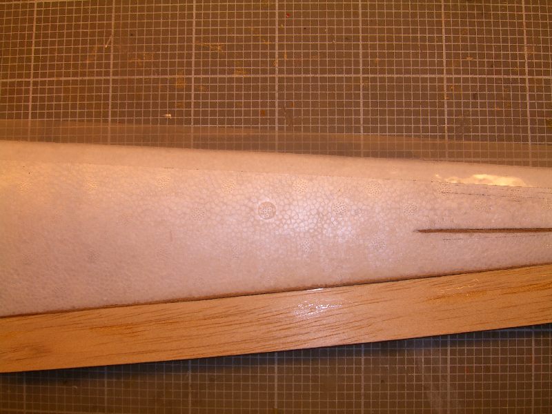

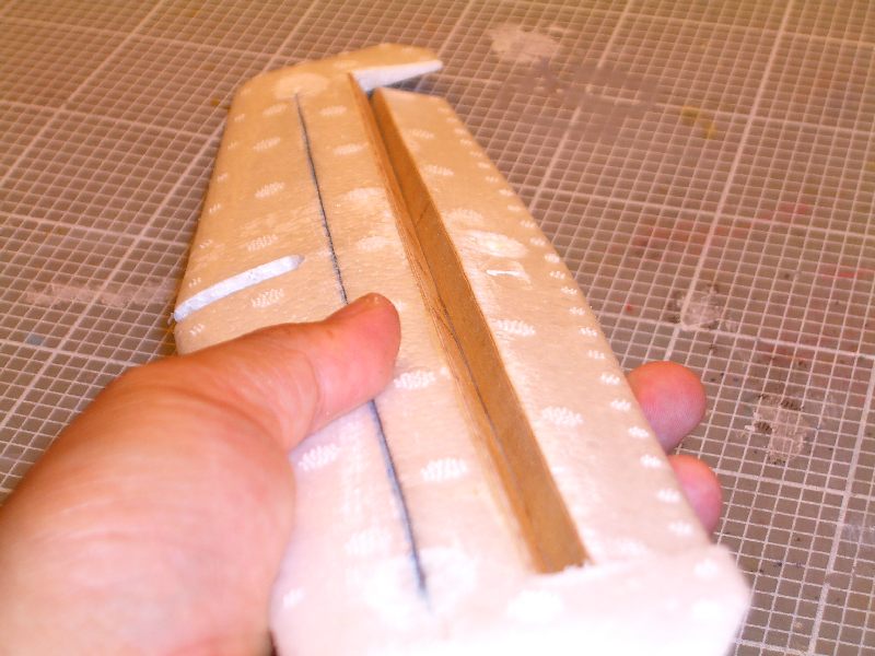

The wing is too thin near the wing tip areas. Need to install a fiber sheet to re-enforce the wing tip
Re-enforce with sheets both on top and bottom of the wing. Look stronger now!
The original design has only one spar of 5mm carbon rod. I installed another spar in front of the cable cabinet in the wing root

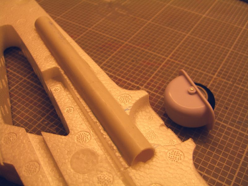

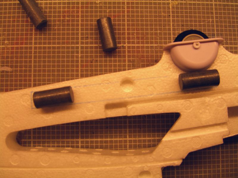

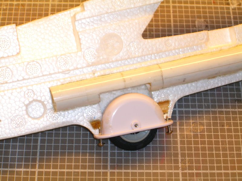

The model is too light to fly unmodified, so I installed a ballast tube on the belly with the exit hole on the wheel chamber. The wheel can be taken off when I need to install ballast.

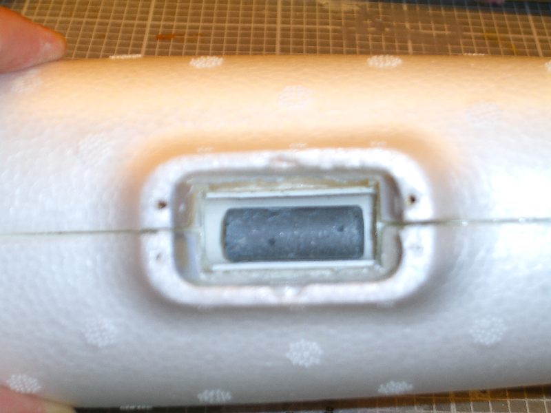

Finished the ballast tube and wheel cradle
Ballast can be easily installed after removing the wheel which is fixed by 4 screws to the cradle

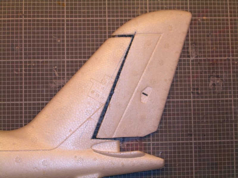

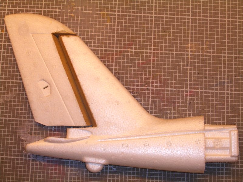

I want a model with good 3-axis manuvourability, so I set up the rudder. The original rudder size according to the molded cut line is too small for yaw motion, so I have to cut a larger rudder.
Reinforce the rudder and rudder cradle with balsa sheet

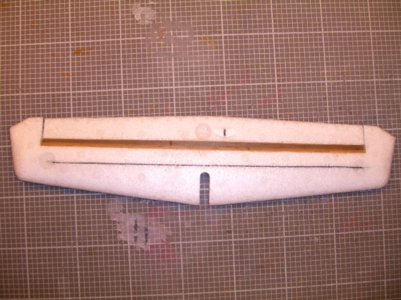

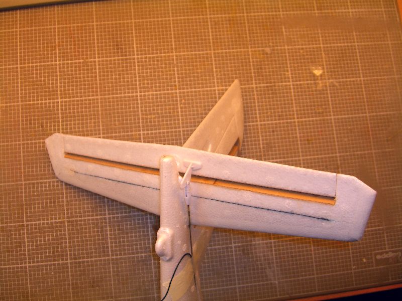

Again, need to reinforce the elevator with balsa sheet
Look good! The movement is free of any obstruction

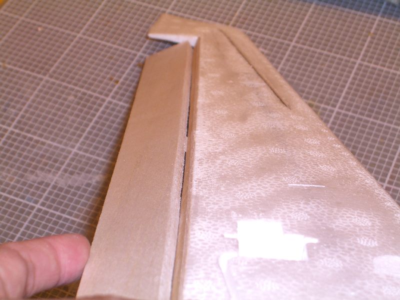

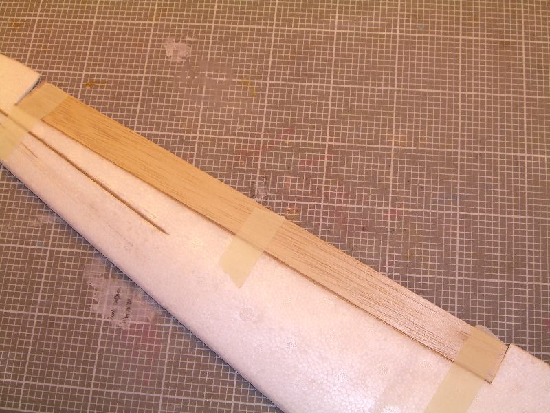

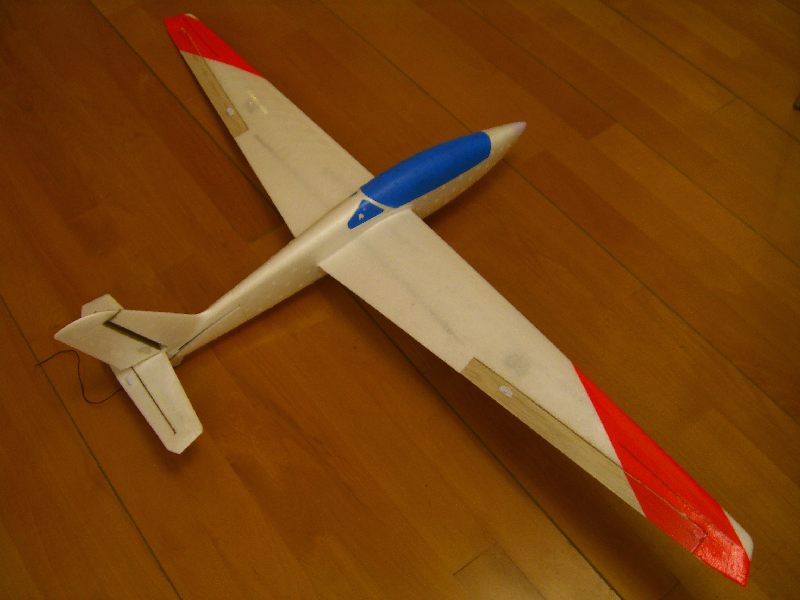

The foam aileron is too soft for serious aerobatic, highspeed dive and DS, so I installed balsa ailerons on the wing.
Look more solid and should be good for speedy flight
Tape the leading edge with strong tape to protect the wing from any unwanted impact

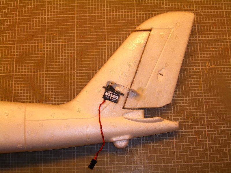

Just installed the rudder servo

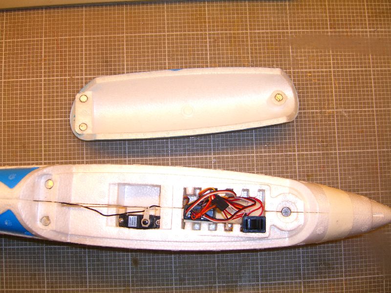

Completed the radio installation and also installed the magnets for holding the canopy

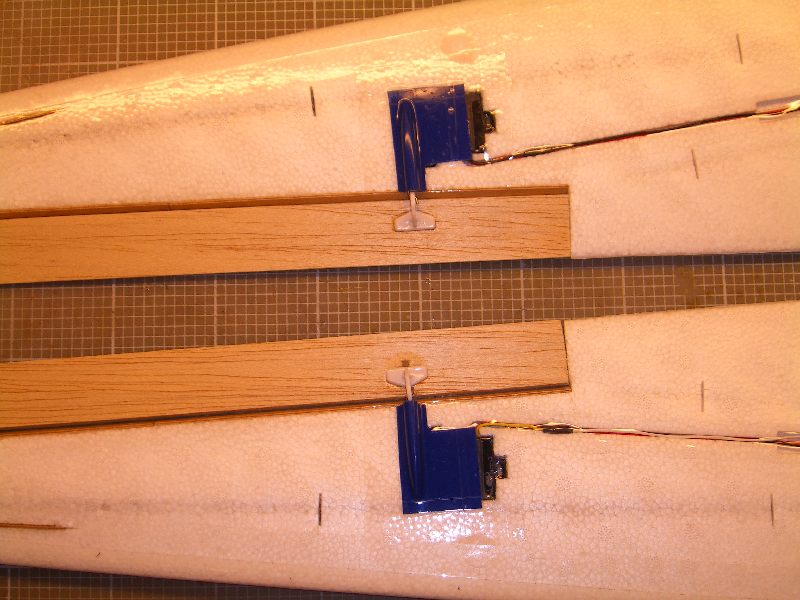

Installed the wing servos.
The original servo bays are for futaba 3016 micro servos. I want to install stronger aileron servos with metal gears, so I cut a larger bay and installed the HS125 wing servo which I hate to use in big F3F planes. Anyway, Hitec gears are easy to break so I also installed a servo cover to protect it from breaking during landing.

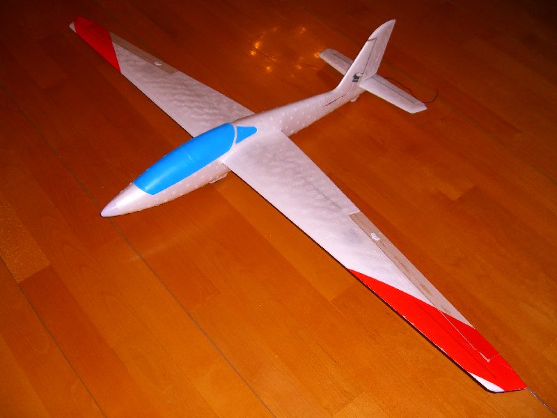

The ballast tube in the belly can carry 300g of lead.
It's now ready and I will test fly this beautiful model this weekend.
