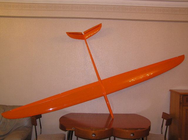

Aris has arrived!
Wow! It's a wonderful plane and beautifully built.
Everything look solid and the construction quality is really high standard.
Two weeks from the coming F3F race, so see whether I can put it up in time.

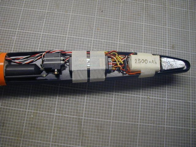

裝坩好電池和開關

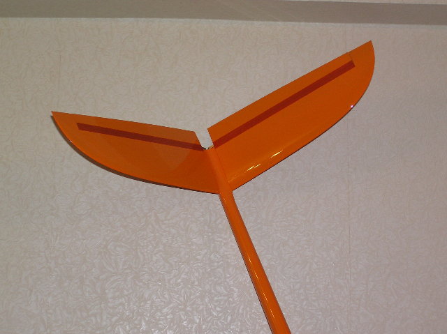

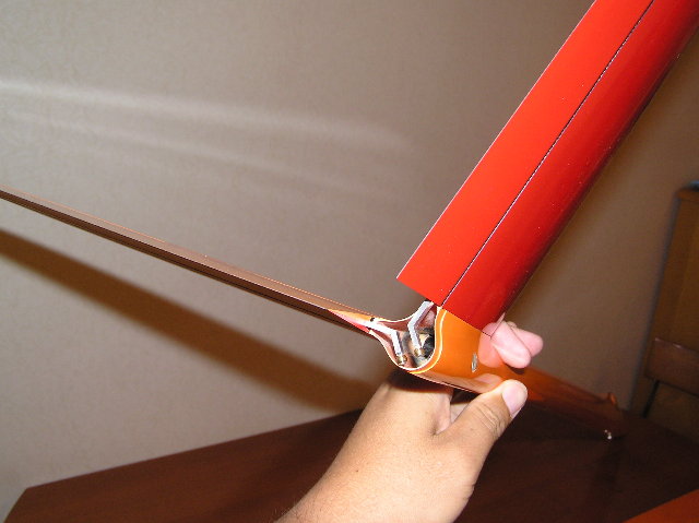

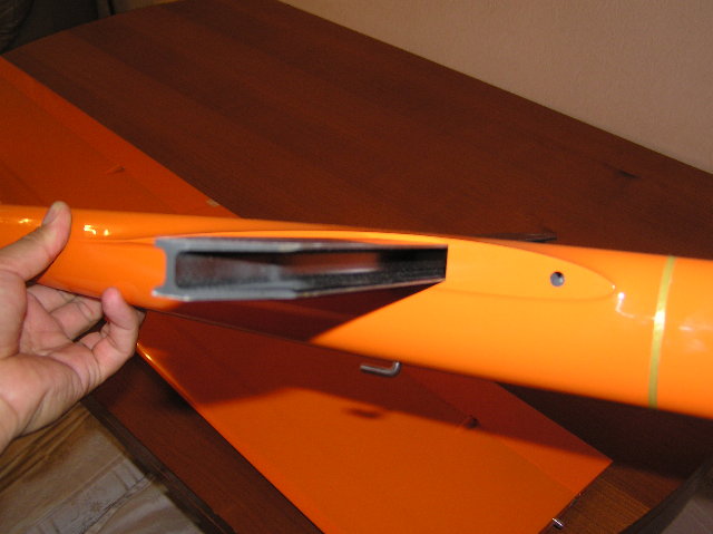

Finished the V-tail servo linkages. Because of the nosecone, space is very tight and I just managed to get enough servo travel after some degree of sanding.
The v-tail is nicely fitted.

Make the cabling for the Multiplex plugs
Installing the plug

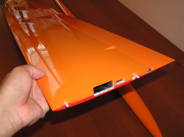

Fitted a Multiplex plug on the wing - my workmanship is a bit .. ha .. ok

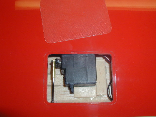

Made a hole for the flap servo linkage
Try fitting the flap servo
PostPosted: Sat Aug 27, 2005 1:55 am
Aileron servo installed
Flap servo installed

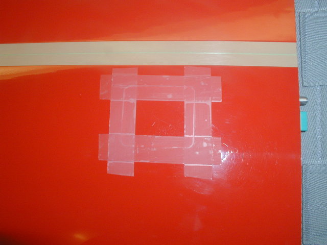

Flap servo bay covered
Final touch on the wiring and install nose lead
